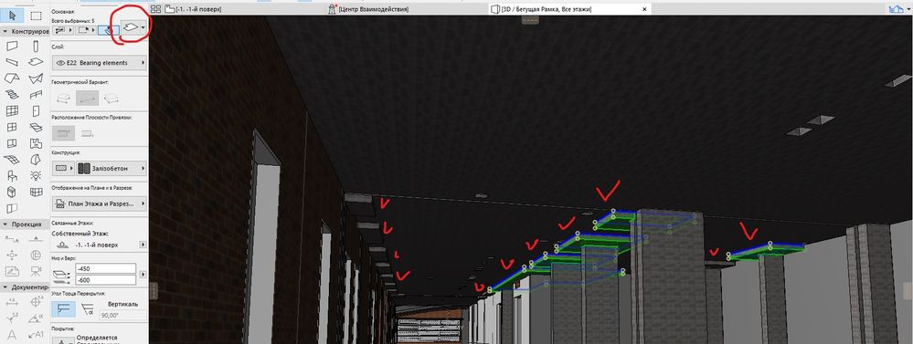

being that no reaction to multi-segment Columns to the Zones after updating them, in large areas, such as underground parking lots, it is necessary to build capitals with a slab tool. Since manually tracing the boundaries of the zone on such a scale is more than inconvenient!

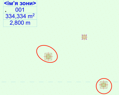

Ok, I try to explain.
No reaction to multi-segment Columns to the Zones after updating them.
1. Create a multisegment Column.
2. Put it on an automatically created Zone (Construction Method: Inner Edge or Reference Line)
3. Update Zone.
After Updating Zones, multi-segment Columns are not subtracted from the Zones (on 2D plans, Zone Area is not subtracted, and in 3D Zone Volume is not changed either). But everything works when you try to Update Zones with the one-segment Column (Zone Area and Volume are subtracted).
As a Technical Support from GS partner, I've created a few requests about this bug around a few versions of Archicad. In Archicad 27, we found this bug and got the comment from GS Support: Unfortunately, we haven't received many reports regarding this, so the issue is currently on hold.
So, let's make some noise around this issue.
Is it clear now?
