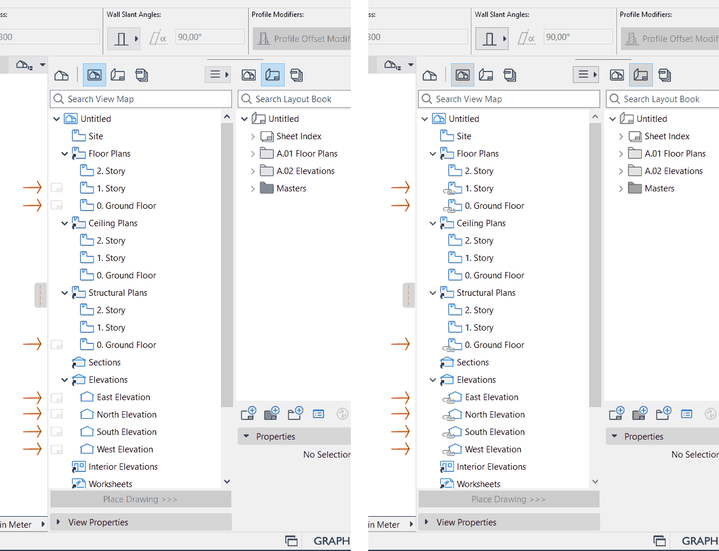

When there are a lot of views in the View Map, it would be nice if ArchiCAD somehow marked views that are inserted somewhere on sheets or simply intended for publication as views.
Thanks to this, a user cleaning the View Map would not accidentally delete such a view.
All you need is a small symbol next to the view, for example a gray Layout icon in front of the View, or a gray paperclip icon, or something else...:

This is one of the most useful features I've seen so far. Totally agree
Also seems useful feature to me. Paper clip icon would be better as views can also be directly linked to publisher set. Or maybe icon could be differentiated based on what the view is linked to.
Currently I'm using Python script to find unlinked views.

Hi All.
Thanks for this wish and feedback, we are working on the ability to show unused views in an upcoming release of Archicad. This is already on our public roadmap here (https://community.graphisoft.com/t5/Product-Roadmap/Search-function-for-unused-views/idi-p/632807).
