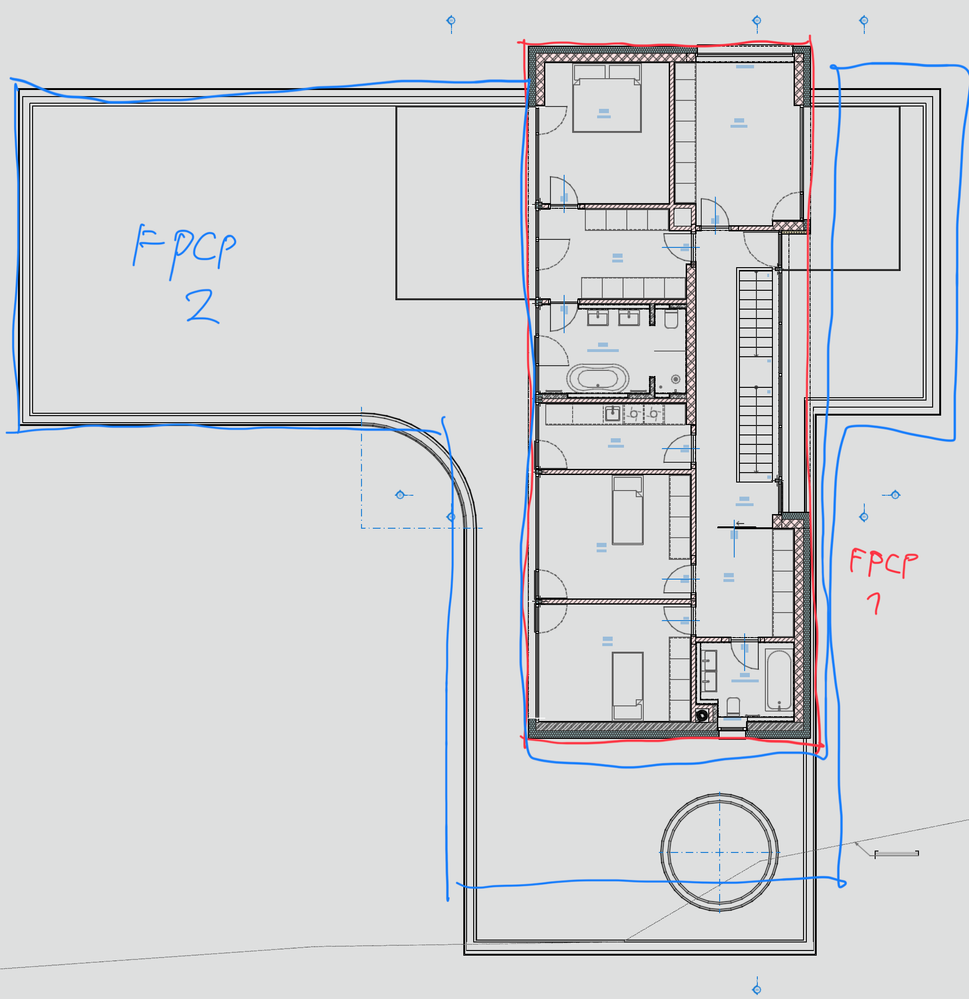

region view on floorplan
Debraeve DIego
What would also be convenient in Archicad (and this is possible in Revit), is that you can draw a local “region view” in the floor plans where you can set the “floor plan cut plane settings” separately for this “region view”. (Useful for example if there are windows drawn at ceiling height that a normal cut plane of 150cm does not show).

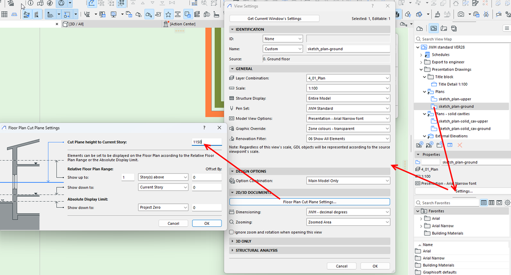

In Archicad, you can have as many views as you like of a plan.
Each view can have its own Floor Plan Cut Plane height.
If you don't want the entire floor plan, you can crop the frame of the drawing (view) when you place it on a layout.
Is this what you are after?
Debraeve DIego
a “region view” that you can draw in floor plan in which you can set in this region view a custom floor plan cut plane hight that differs from the floor plan cut plane hight in the floor plan settings
In your storey view, you can set the Floor Plan Cut Plan settings as you wish.
You can then duplicate the view and make completely different settings.
So you can have as many views of the plan as you like with as many different settings as you want.
If you are working in the Project Map, you can only have one sett of 'master' settings that you have to manually set.
But if you work on views that you have saved in the View Map, they will remember your settings.
It is these views that you place on layouts as drawings, so you never have to worry about the settings.
Barry, what the op is saying is that this can be done in Revit relatively easily by creating a polygonal boundary and setting Floor Plan Cut Plane settings for that region that are different from the Floor Plan Cut Plane settings of the whole View. No need to save various Views and arrange them on a Layout. It would be a faster/more elegant solution.
So you have a region inside the main plan that has a cut plane that is different to the main plan outside of that region?
One plan (view) with two different areas with different cut planes?
That could still be done with 2 views overlaid on a layout.

What @Debraeve DIego is suggesting is great and I think it represents an item from old Roadmap about stories settings (I don't remember the name and now the old roadmap site is not available).
One thing is to be able to locally change the Floor plan cutting plane for a windows but if there is a large scale project where there are multiple levels in one storey, this is a situation where this is more needed.
What is @Barry Kelly saying is for me a workaround and not a good one since I need to either turn on trace and reference to see the other parts of the whole layout or have a look on the layout itself.
Also, for this locally set floor plan cutting plane there should be a setting to set the height to where this part can see (same as is currently in the Floor plan cut plane settings).
