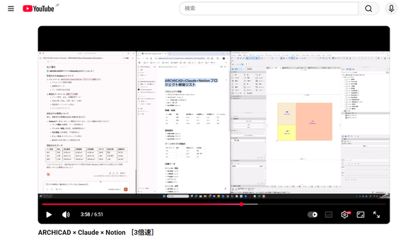

I’m a Japanese Archicad user, and I’d like to share my experience related to this topic.
I am a Japanese Archicad user, and after seeing the links you shared, I also tried creating an experimental “Claude × Notion × Archicad” workflow.
 https://www.youtube.com/watch?v=F3jVaR2au7Q
Similar to the examples, I used the Tapir add-on to build a pseudo-MCP environment, where Claude can extract zone information from the Archicad model and write it into Notion.
In Japan, I also know several cases where people are experimenting with using Cursor as MCP hosts.
Recently, even some government-related digital services in Japan have started adopting MCP, which shows how rapidly this ecosystem is expanding.
“MCP-Centered Workflow Architecture for BIM and AI Integration”
Because of this momentum, I strongly believe that MCP support will revolutionize the workflow between BIM applications, external systems, and AI agents.
