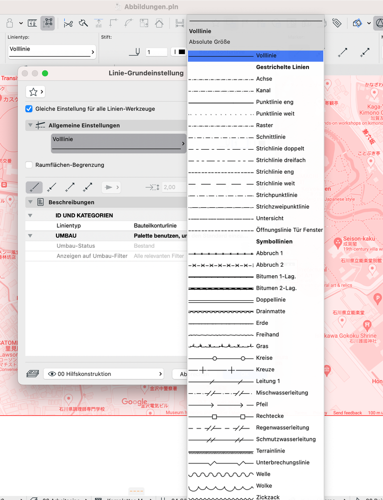

After the update it seems like my drop down menu its not working... I can't change line types, bc I couldn't click on them. Its stuck on the first choice. Is there any way to solve this problem? Appreciate the help.

Known bug on macOS Ventura. Use arrow keys!

THANK YOU SO MUCH IT WORKED

Supposedly this is fixed with the latest update but can confirm that the bug is still apparent.
Also i have noticed the building material will bug out there I have to press the dropdown multiple times before options come up. It's almost like a lag.

However, I am using Archicad 26 (education version) and am still having trouble with this problem where I can't select the line with my mouse. The link that you provided mentions that this should've been resolved in Archicad 26. Thanks to ole saalmanns comment above I was able to solve this by using the arrow keys. I am a brand new user of Archicad, so I thought I was going mad for a while there, ha ha. I hope it can really be resolved in Archicad 26 soon!

I updated my ArchiCAD to the latest yday and the issues have now been resolved. It is worth checking if your ArchiCAD 26 is up to date. Assuming education version can run updates.
