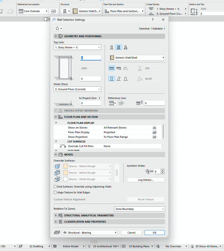

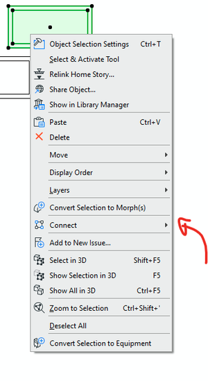

Hello. I am trying to implement one algorithm but for that I need somehow to detect that you have opened a certain window in Archicad that changes the focus of the application to that window, for ex. a modal dialogue or windows such as those:
or
or
I guess you got it. Do you know any Archicad API command that could help detecting such focus changes? I have been searching for that command, however, I am either blind or the command does not exist. Thank you in advance!
