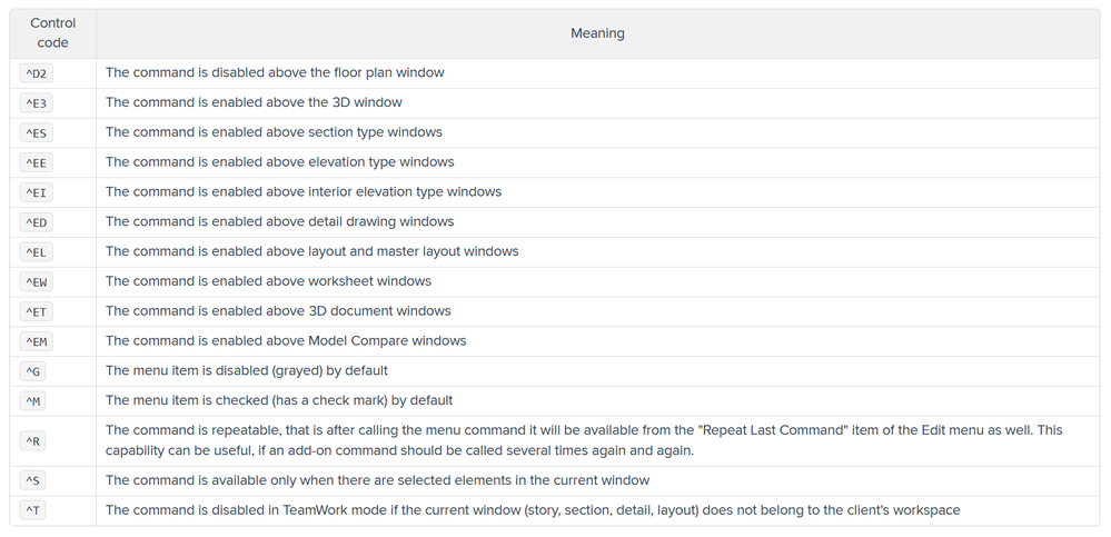

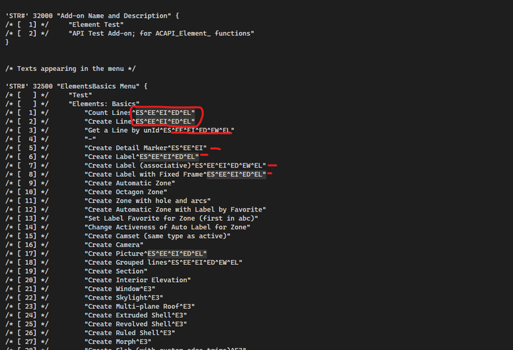

Hello everybody. I want to know what do those things means in the RINT folder
... ES^EE^EI^ED^EL"..
2 ACCEPTED SOLUTIONS
Solution
Miha Nahtigal
These are control codes for menu items that control if menu item will be enabled/disabled in specified view (floorplan/section/elevation,..)
I think the definitions were in API Devkit 26  but dissapeared in newer devkits.

Solution
Archicad 28 C++ API: Required Resources
This is the link to the definitions 🙂
