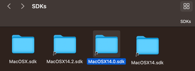

vdentello
I figured out a very dumb solution that worked for me.
I noticed that the MacOSX14.sdk is just a shortcut that points to MacOSX.sdk
I simply duplicated and renamed the shortcut to MacOSX14.0.sdk (with the explicit) .0 so the compiler sees the path and the build works.
