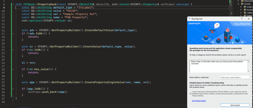

Hello guys. I was coding the hookers for Archicad 29 and something went wrong. I was following the examples in IFC_Test, and I wrote the code:
I have also executed this code that gave no errors:
IFCAPI::GetHookManager().RegisterPropertyHook(IFCHook::property_hook);
However, for some reason, after the ending of execution of property_hook(), I received this exception error:
I want also to point out that the ifc values were creating fine, without any errors. I was checking it a lot of times through the debugger.
Have someone dealt with this issue before? I would be glad if someone could point me to my mistake. Thank you in advance!

OK, I just saw a possible solution. Are you making a Debug build? Try compiling it as a Release build.
Somebody else seemed to have a very similar problem in AC29 TP and this was their solution. (https://community.graphisoft.com/t5/Graphisoft-Technology-Preview/Crashes-when-invoking-property-hoo...)
This relates to an issue I had a while back with Debug builds. Check this post to see how you can adapt your Debug build once you've confirmed that it was the issue by trying the Release build: https://community.graphisoft.com/t5/Archicad-C-API/Crash-for-GetOrganizationIds-in-DEBUG-builds-link...

Hi, please let me confirm what problem you're facing, did you mean you meet the error even using API29 Examples code? I noticed there are similar code like AddProperty() in IFCHook_Test.cpp.
Emkave

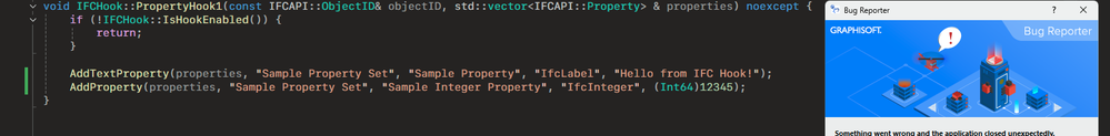

Hello. Thank you for the reply. The issue I face is when the PropertyHook function finishes its execution after I had put values into the property vector.
In this screenshot I am emplacing the test value. Then the execution line goes out of this function and Visual Studio complains about the exception:
I suspect that I have emplaced the property incorrectly, however I am sure I correctly understood the way it supposed to be according to the examples from Graphisoft.
Emkave

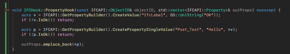

I have tried again; did read the examples and documentation and wrote this code:
however it still causes Archicad to crash with the same exception when the execution of PropertyHook ends.
Hiromichi Shinkawa
Hi, could you reproduced the same crash using the example code AddProperty() in IFCHook_Test.cpp?
Emkave
Yes. Crashed again when I tried to use AddProperty from IFCHook_Test.cpp.
I have literally copied and pasted their functionality.
