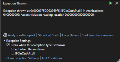

Hello guys. I was coding the hookers for Archicad 29 and something went wrong. I was following the examples in IFC_Test, and I wrote the code:
I have also executed this code that gave no errors:
IFCAPI::GetHookManager().RegisterPropertyHook(IFCHook::property_hook);
However, for some reason, after the ending of execution of property_hook(), I received this exception error:
I want also to point out that the ifc values were creating fine, without any errors. I was checking it a lot of times through the debugger.
Have someone dealt with this issue before? I would be glad if someone could point me to my mistake. Thank you in advance!

OK, I just saw a possible solution. Are you making a Debug build? Try compiling it as a Release build.
Somebody else seemed to have a very similar problem in AC29 TP and this was their solution. (https://community.graphisoft.com/t5/Graphisoft-Technology-Preview/Crashes-when-invoking-property-hoo...)
This relates to an issue I had a while back with Debug builds. Check this post to see how you can adapt your Debug build once you've confirmed that it was the issue by trying the Release build: https://community.graphisoft.com/t5/Archicad-C-API/Crash-for-GetOrganizationIds-in-DEBUG-builds-link...

Also I noticed that it is trying to load up IFCInOutAPI.pdb from somewhere. I went to check out in the devkit for AC29 and it does not exist there.
I also tried to search for IFCInOutAPI.dll, but it does not exist either

And here is the debug message:
Exception code: C0000005 ACCESS_VIOLATION reading location: 0000000000000000
Fault address: 00007FF9CC1969FE 01:000059FE IFCInOutAPI.dll

Hi, please let me confirm what problem you're facing, did you mean you meet the error even using API29 Examples code? I noticed there are similar code like AddProperty() in IFCHook_Test.cpp.

Hello. Thank you for the reply. The issue I face is when the PropertyHook function finishes its execution after I had put values into the property vector.
In this screenshot I am emplacing the test value. Then the execution line goes out of this function and Visual Studio complains about the exception:
I suspect that I have emplaced the property incorrectly, however I am sure I correctly understood the way it supposed to be according to the examples from Graphisoft.

I have tried again; did read the examples and documentation and wrote this code:
however it still causes Archicad to crash with the same exception when the execution of PropertyHook ends.
2025-09-24 03:46 AM
Hi, could you reproduced the same crash using the example code AddProperty() in IFCHook_Test.cpp?

Yes. Crashed again when I tried to use AddProperty from IFCHook_Test.cpp.
I have literally copied and pasted their functionality.
