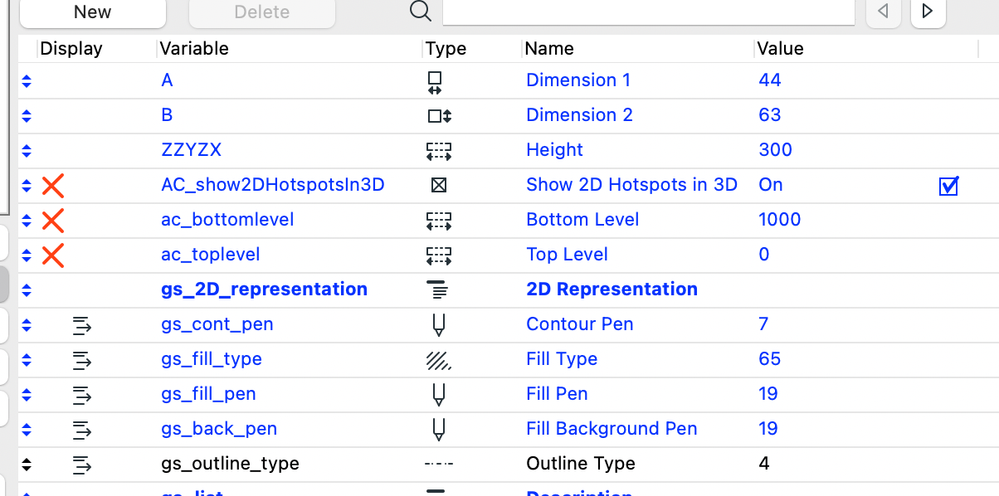

1.  open the object
2. in Details push button Select Subtype and select the subtype from Subtype Hierarchy. When you do that open Parameters. You will find there new parameters in blue colour, they are default parameters for this subtype. They start usually with gs_ name. Explore the gs_2D_representation subgroup,  all parameters responsible for 2D are there. Important to use always those parameters in 2D script and add new 2D parameters to this sub group.
3. open 2D script of your object. Make sure that you have Project2 2, 270, 2 on the top of 2D script. If there is anything else then select all and push Comment button, this will temporary disable existing script.

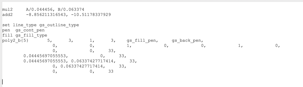

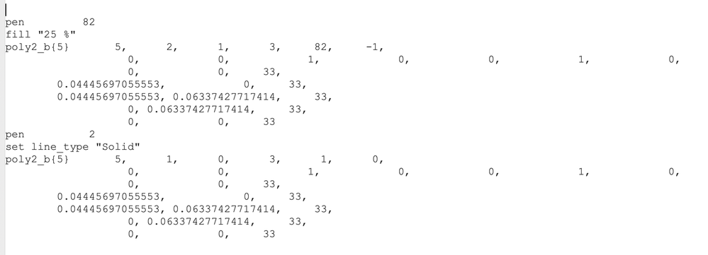

8. open 2D script window next to 2D Symbol window. Select one fill  and Command D or Control D (drag) to 2D script window. It sold look like print screen below. poly2 script on top is responsible for fill, poly2 under set_line is responsible for outline.
9. now if you want to keep script short and be able to understand what is what
type above copied script
!!!!!!!!!!!! name of the part of the object
and replace in script fixed values with parameters
pen  gs_cont_pen
fill gs_fill_type
poly2_b (5)     5,   3,   1,   3,   gs_fill_pen,   gs_back_pen,
gs_cont_pen = outline of fill pen
gs_fill_type = fill type
= fill with outline, 2 = just fill, 1 = just outline
gs_fill_pen = hatch pen
gs_back_pen = fill background pen
number 33, in the end of numeric lines = cut line, number 1, = outline. Those lines will do differently on plan but will print as pen assign to them.
if you want to have control over the outline type than copy and paste set_line_type "solid" above pen gs_cont_pen line and change "solid" to gs_outline_type Add this new parameter to parameter list
10. You can delete second poly. Check Script and if all is ok, open 2D View and select part you have just scripted in 2D it should show fill. From now on you will be able to change outline, fill and pens of that part.
