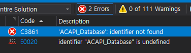

I am trying to put an id while creating a beam.
I think it will be easier to understand if there is a code.
Which code in the example can I understand?
AC27 on window 11
err = ACAPI_Database(APIDb_ChangeElementInfoStringID, &element.header.guid, &na);
ACAPI_Database not found in archicad 27 api
There is also no content in ACAPinc.h.
What should I study?
And I don't have apidevkit.chm, where should I search for it?
