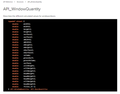

hehey luna.
i did not try it bymyself but have you looked at the api_windowquantity struct from more quantitys?
looks promising. could be that one of the surface parameters returns waht you want.
https://archicadapi.graphisoft.com/documentation/api_windowquantity
Hi, Joel
Thank you for providing the method. I will try it next.
Allen.
my first suggestion was that you go after the standard properties of windows/door. if this works you would have a neat and simple solution.
the other, and unfortunatly from me also untestet approach, would be to get the library part details and analyse those.
but it seems that this struct reveals no real usefull information for your use case:
https://archicadapi.graphisoft.com/documentation/acapi_libpart_getdetails?s=ACAPI_LibPart_GetDetails
https://archicadapi.graphisoft.com/documentation/api_libpartdetails
