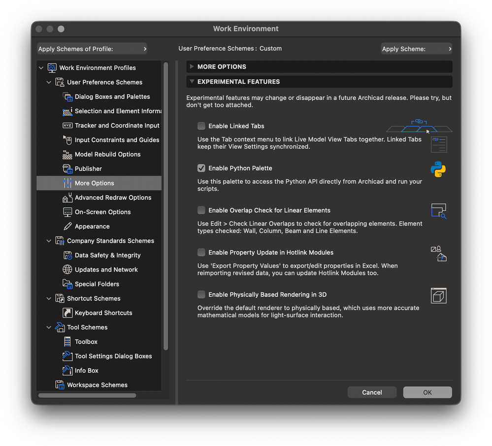

Akos Somorjai
Hi Mats!
You can also turn on the Python palette in the Experimental features, and open it from the Window/Palettes menu – I think it is close to what you need.
Best, Akos
Mats Knutsson
To answer all:
I use the Python addon but not Tapir ( I will use it for publishing and preferably automatic publishing). Will look into Perisso when I can squeeze time.
I just want to see the workflow how to create a small palette...could be anything really.
/M
