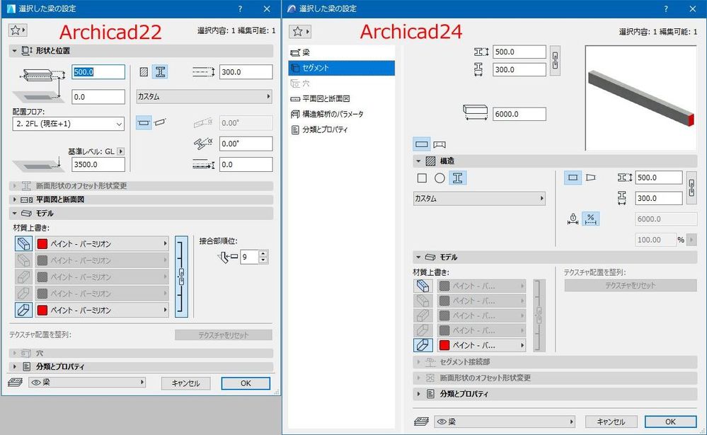

HKM
Custom section beams do not match description.
For custom sections, 'Extruded material'(translated from Japanese) is displayed at the top of the material.
HKM
Check before and after segmentation.
use "Do_TestMaterialChaining()" of SDK Example "Element_Test".
Archicad 22 (before segmentation)
modified to "overridden = true" for all materials(side/bottom/left/right/right/top).

Result
Extrusion side surface material is chenged
Archicad24 (after segmentation)
modified to "overridden = true" for all materials(left/right/top/bottom/ends).
case API_BeamID:

Result
Extrusion side surface material is not chenged

Hiromichi Shinkawa
If your problem is you're not able to change the profile beam side material with API, then it's true.
