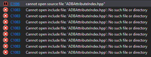

cannot open source file "ADBAttributeIndex.hpp"
Need help about this errors

RAFD
I'm trying to upgrade the add-on to AC27 but I got errors while building the add-on
Hiromichi Shinkawa
The file is in the following folder of API kit:
"\Support\Modules\CADInfrastructureBase\"

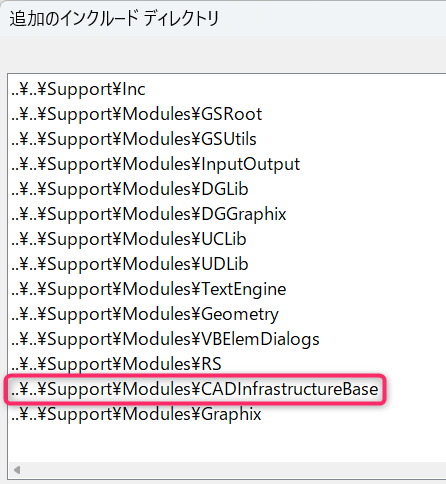

Hiromichi Shinkawa
Please try to add the path into your VS project Include Directory like below:

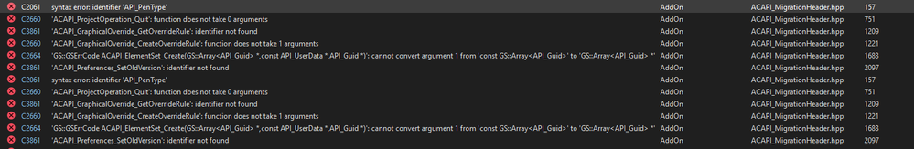

RAFD
I tried including the ACAPI_MigrationHeader.hpp and now all my errors are in that file
