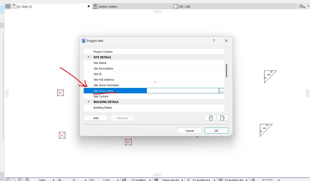

Hi everybody,
Do you know how to get site gross area in ArchiCAD using API?
(Image is attached below)
If you know, please help me
Thank you very much

Hi!
Unfortunately, I don't think that's possible.
You can get the Project Details further up in the Project Info dialog with ACAPI_ProjectSetting_GetProjectNotes in AC27.
(for <=AC26 similarly with ACAPI_Environment (APIEnv_GetProjectNotesID, &noteInfo))
But I couldn't find anything for the Site Details.

This should be possible (I've noticed that some of the addons are adding/changing project properties).
BIMquants.comBETA - Quantities and Costs Estimation in Archicad - BETA testers needed.
Good hint @Miha Nahtigal! With that info I was able to find something 😉
It's together with the AutoText stuff. Check out ACAPI_AutoText_GetAutoTexts.
