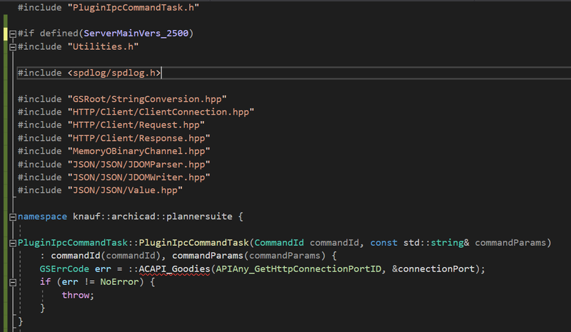

Hello everybody guys, my question is the following:
I saw that in the `ACAPIinc.h` file there are many constants for the software version like `ServerMainVers_xxx`, now I', doing the migration to AC27 and I saw that there are some old code blocks that are signaling through intellisense a compiler error.
Basically they can't find the new functions definition wrapped by the `MigrationHeader.h`, but they actually shouldn't search for it since that piece of code should be for AC25.
#include "PluginIpcCommandTask.h"
#if defined(ServerMainVers_2500)
#include "Utilities.h"
#include <spdlog/spdlog.h>
#include "GSRoot/StringConversion.hpp"
#include "HTTP/Client/ClientConnection.hpp"
#include "HTTP/Client/Request.hpp"
#include "HTTP/Client/Response.hpp"
#include "MemoryOBinaryChannel.hpp"
#include "JSON/JSON/JDOMParser.hpp"
#include "JSON/JSON/JDOMWriter.hpp"
#include "JSON/JSON/Value.hpp"
namespace knauf::archicad::plannersuite {
PluginIpcCommandTask::PluginIpcCommandTask(CommandId commandId, const std::string& commandParams)
: commandId(commandId), commandParams(commandParams) {
GSErrCode err = ::ACAPI_Goodies(APIAny_GetHttpConnectionPortID, &connectionPort);
if (err != NoError) {
throw;
... doing other stuff
#endif
Somehow I'm not using correctly the constants, since they are all enabled (this piece of code shouldn't be considered since I'm working on AC27 ADK Solution).
Thanks in advance 🙂
P.S.: I know that by placing the migration header I would solve the intellisense error, but actually I don't really solve the underlying issue.

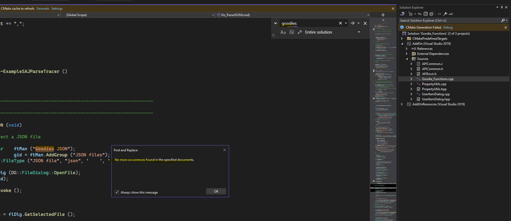

im sorry im kinda having troubles to understand the question. waht is a adk? do you mean SKD?
i can only comment on this: you state that you do a migration to AC27:
"I', doing the migration to AC27"
but you are using the ACAPI_Goodies API Call, that does not exist anymore.
https://graphisoft.github.io/archicad-api-devkit/modules.html
i think your call is now in the AC27 API named "ACAPI_Command_GetHttpConnectionPort()"
i didnt knew that there is a migration header. haha. cool stuff.
check out the goodies example. there is no API Call left that has the name goodies in it.
as a comment: i really like that they renamed those functions. "goodie" was as meaningless as a namingconvetion can be.

If you build for AC27 then ServerMainVers_2700 is defined but all previous versions are also defined (why?).
So, instead of writing code like this
// code for AC25
#endif
you can do this
#if !defined (ServerMainVers_2700)
// code for AC26 and older versions
#endif

Thanks for both the answer guys, this is what I was searching for.
#endif
The code between the pre-compiled headers is working until AC26, and not only for AC26.
