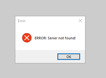

 I installed the latest version of revit Archicad ifc exchange plugin today. I am getting an error denoting server not found whilw importing an IFC from Archicad 26 into revit 2023. Kindly help.
1 ACCEPTED SOLUTION
Solution
Hey!
Thank you for your help. Please download the latest installer from the site and it should be good: https://graphisoft.com/downloads/interoperability
You have an older installer (it was uploaded 2022 September) which has this problem that MTMLib.dll is missing but the latest installer is from 2022 October and that is correct.
I hope after this you can use this product without any problem.
With regards,
Attila KucsvĆ”n

Can you guys show a screenshot of this? If this happening in Revit when using the "IFC Model Exchange with Archicad for Revit 2023" Add-In?

Hi!
I suggest everyone who has this problem to do the following things:
  1. Open the Revit Addin installation folder, typically is C:\Program Files\GRAPHISOFT\IFC Model Exchange with Archicad for Revit 2023\2023.
  2. Double click on RevitConnectionServer.exe
  3. If it comes up some error message which says that there are some missing dll-s try to reinstall the software
  4. After reinstalling check again if everything is OK with RevitConnectionServer
I have had situations when this helped me. I hope I could help for you!

This seems to be the problem in my case.
When I double click on RevitConnectionServer.exe the error message says NMTlib.dll couldnt be found.
After reinstallling several times im still missing the same .dll File.
Does anyone have a soultion for this?
Additional Information:
- Im using Revit 23 and installed the addin for 23
- Revit and the addin are installed on my harddrive
- when trying to import the IFC it loads for about 30min then i get the error message:SERVER NOT FOUND
