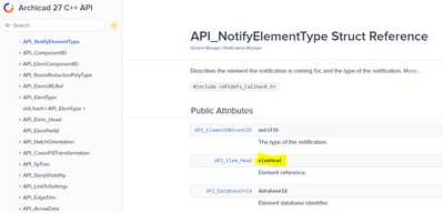

New Year greetings to all.  I am migrating code from AC25 to AC27, and Visual Studio is giving me some pushback that I don't really understand.  I might add that I am not the original author of this code.  The working AC25 code is this:
#include <APIdefs_Elements.h>
// Element driven events
GSErrCode __ACENV_CALL NewElementEventHandler(const API_NotifyElementType *notifyElemType) // new element
	GSErrCode err = NoError;
	// Do nothing if the live audit is not enabled
	if (!JHP::LiveAudit::GetInstance().Enabled())
		return err;
	if (notifyElemType->elemHead.typeID == API_DimensionID)
		if (notifyElemType->notifID == -1)
			JHP::LiveAudit::GetInstance().Observe(notifyElemType->elemHead.typeID, notifyElemType->elemHead.guid);
	else
Visual Studio is telling me:  class "API_Elem_Head" has no member "typeID"
My research into this is:

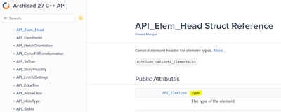

Making the edit from .typeID to .type seems to work for the if condition [0], but is not happy when used in the .Observe arguments [1, 2].

Prior to Archicad 26 the element type was represented by a single enum of type API_ElemTypeID. Starting from Archicad 26 the element type is represented as a struct named API_ElemType. It contains the same enum as before, but also contains other identification data (like API_Guid for identifying external elements, like the new MEP elements).
What can you do?
  1. You can continue using the API_ElemTypeID enum from the API_ElemType struct. It will work as long as you don't want to use new elements appearing in Archicad in the future.
  2. Rewrite your code to use API_ElemType everywhere so you will have a more future-proof implementation.
@Viktor Kovacs  - thanks for the info.  I will rewrite code to use API_ElemType everywhere so we have a more future-proof implementation.  That just makes sense.
But...  if I am allowed to continue using the API_ElemTypeID enum from the API_ElemType struct, why would this be reading as an error now, without making any edits?  Just curious...
Thanks for your continued support and insight,
Chris

The type field was earlier an enum, and is now a struct. If a function expects an enum than it won't compile. The other way will silently work because API_ElemType has a non-explicit one-parameter constructor with an enum value, so the compiler will construct the object automatically.
MudratDetector
@Viktor Kovacs - - thanks agian for the detailed explanation.  I feel like this is basic stuff, but I don't know what I don't know.  After your comments, I was able to correct all of these API_ElemTypeID vs. API_ElemType instances in my project in a matter of a few minutes.  Also - a few other edits to respond to changes in the API since AC25.

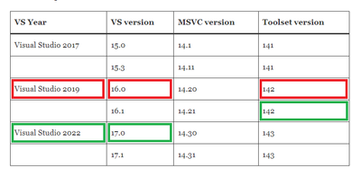

Check these two things that changed between AC25 and AC27:
Hope that helps.
MudratDetector
@Viktor Kovacs - thanks for the reply.  I have previously read the first link you provide regarding the toolset change.
I understood this
"If you try to use VS 2022 to build your AddOns, you have to keep in mind a few things."
with an emphasis on "try", as - - if I was using VS2022 with toolset 143, I need to back off to toolset 142, but since I was using VS2019 with toolset 142 [and not trying to use 2022], I was OK.
However, your second link really makes clear the need for C++17, which I had not picked up on until now.  And I have not had any issues with prior migrations of four add-ons from 25 to 27.  They are loading and working without issue in AC27.
I now understand my path is to change my current configuration [in red] to the necessary configuration [in green].
Any idea why the previous four add-ons are in working order for 27?
Or what about these last two are finally making me take notice?
Just curious...
You have been loads of help on this particular learning exercise.
It is greatly appreciated!
Chris
