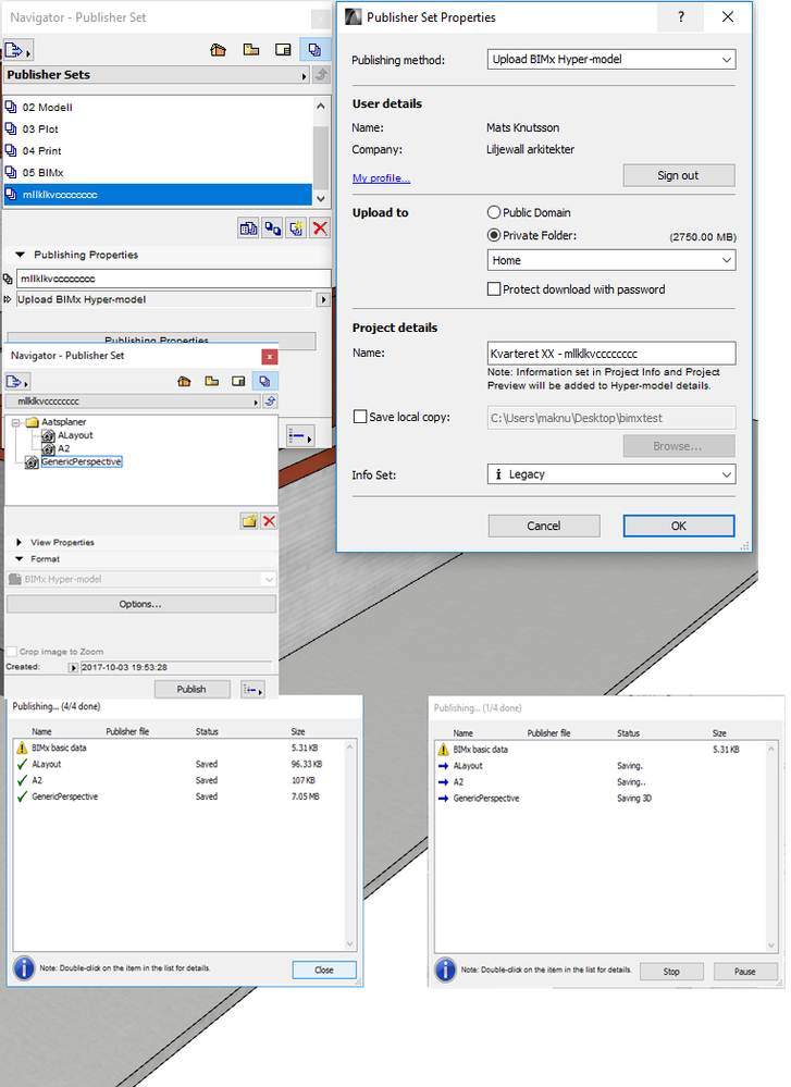

Worked great before but now I just get a 3D perspective...what could've happened?

I think you should try to "Save File" instead of "Upload Hyper Model BimX"
Then choose to do a "single file" as a BimX (and not a pdf)
Is your mistake always present ?

Now it's working....also the German message is now in English as it should....GS must have corrected both bugs at the same time.
