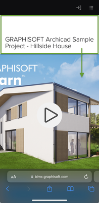

But I can not download the demo hyper-model - says my browser is not compatible.
Maybe my phone is too old.

Hi, please send the model to bimx@graphisoft.com. Our support team will investigate this issue with high priority. The web application on iOS/iPadOS is not supported currently - see more details in this comment. To import models to the iOS app, scroll down to Download by tapping above the web app's frame:
We plan to enable scrolling on the full interface soon.
