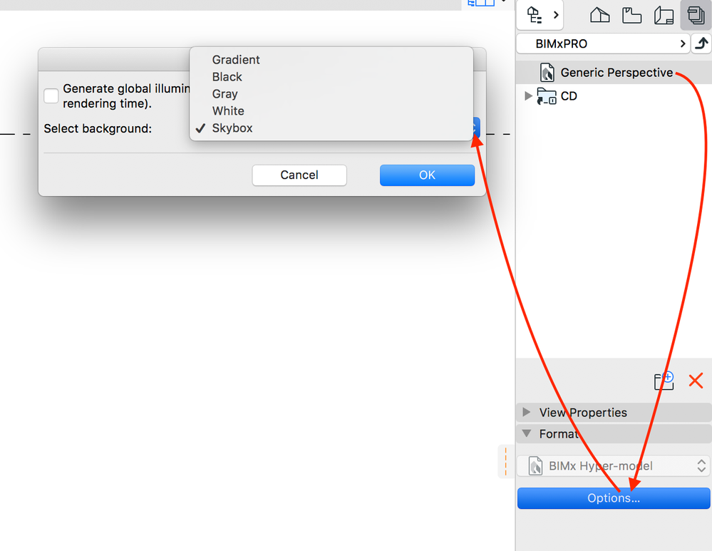

Isaac, in ARCHICAD 20 when you create the BIMx file you can choose between nuclear wasteland, gradient, black, white, and gray. I'm not sure where the gradient comes from, or if there's a way to set it to colors you'd want. My guess is white is the way to go 99% of the time, if the default skybox bothers you.
http://helpcenter.graphisoft.com/guides/archicad-20/archicad-20-reference-guide/visualization/graphi...

Jared Banks, AIA
