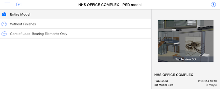

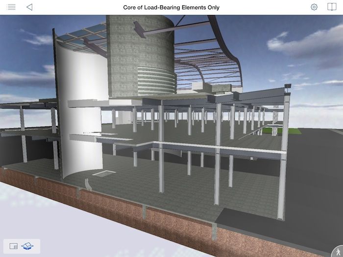

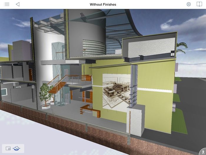

1. Showing different construction stages
You can filter a building’s structural elements with Partial Structure Display in ARCHICAD. This enables hiding finishes of the building or showing only load bearing structures - this can be useful to check the statical frame of the building at the construction site for structural engineers:
Entire buildingBuilding without finishesStructural model
NHS Office Complex - Ivo Venkov PAASTUDIO - Los Angeles, CA

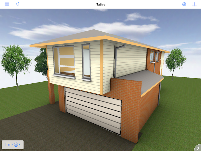

2. Presenting design alternatives with Layer Combinations
If there are more than one designs for a project and you would like to show all of those to the Client simply, you can save 3D views in your ARCHICAD project with different Layer Combinations each showing only one of the designs. For example there are four proposals for an exterior of a family house. If all of them are visible in the same .PLN file you can put their views into the BIMx file to get this result:
Design variation 1Design variation 2Design variation 3Design variation 4
Residential Project - Ausbuild Pty. Ltd. - Queensland, Australia

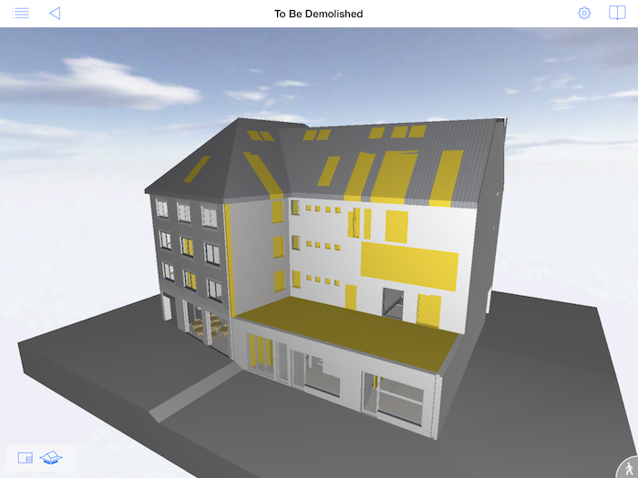

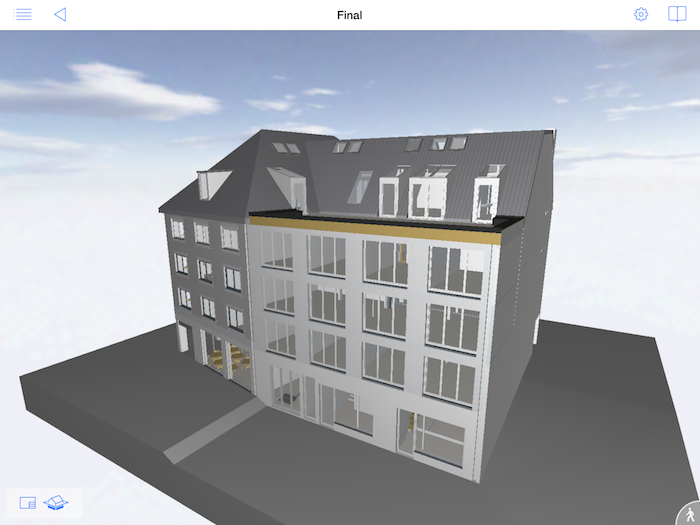

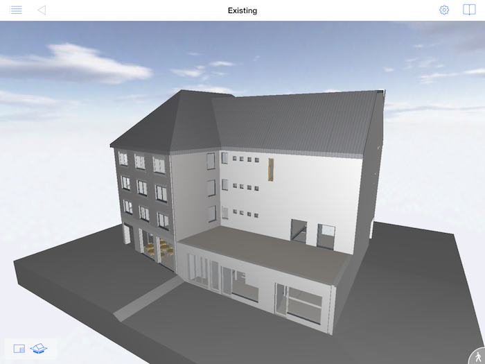

3. Renovation Status display of the project
When a building is renovated you have separate stages of the reconstruction such as existing state, demolish works, new construction etc. These stages can be shown in ARCHICAD with the Renovation Filters. Elements highlighted with yellow color are 'to be demolished' while new construction is marked with red. This way you can get a quick overlook of the building refurbishment:
Existing BuildingDemolish worksNew constructionRefurbishment completed

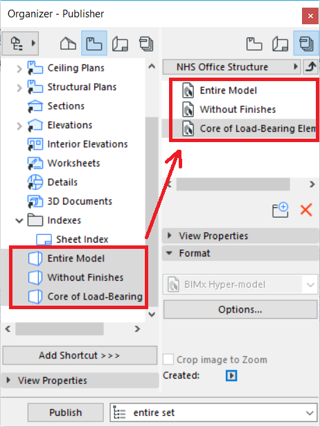

How to create such BIMx models?
First of all we need an ARCHICAD BIM model containing all the necessary information we would like to show in our BIMx file. To have multiple 3D models in one BIMx file we set up 3D views in ARCHICAD filtering the BIM data according to our goal with view filter options:
Use Layer Combinations, Partial Structure Display options, or different Renovation Statuses to present different stages/variations of the project. When the 3D views are created we open the Organizer from Document > Publisher... and set up the BIMx Hyper-model Publisher set. Check the step-by-step guide how to create a new Publisher set here. We place the model views into the publisher set with the drag & drop function:
After pressing the Publish button the BIMx Hyper-model is saved (either to the BIMx cloud or to our local machine). Transfer the file to your iOS device, as a result you will see all the 3D views in the file:
