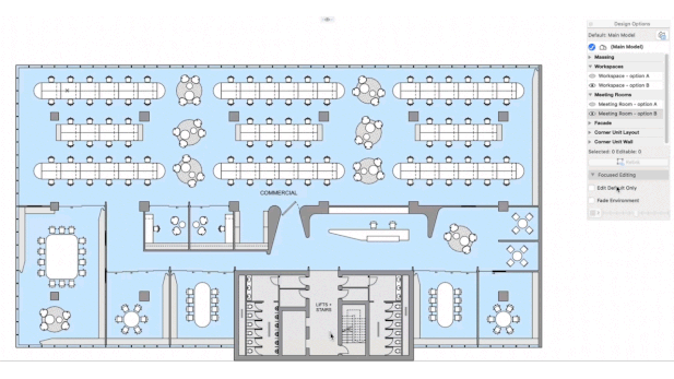

Design Options: Represent the individual variation of a design — for example, a variation between a building with a flat roof and another with a pitched roof.
Design Options Set: You can create as many categories as necessary to manage multiple design variations — for example, you can create a set for the Roof and another for the Facade, and under each "group" have different design options.

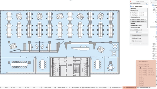

Design Options Combination: This enables us to visualize different design options from other sets simultaneously, similar to Layer Combinations. By creating a combination, you can decide what design option will be visible from your settings and access all these new combinations on the quick options bar, as shown in the picture below.

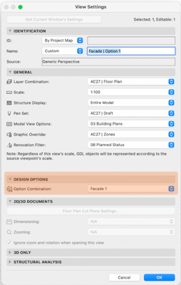

Design Options are a view-based setting, which means you can choose your desired settings via any 2D or 3D output. You can create a new view and select one of the Design Combinations to be displayed, then arrange each Option's views on a layout for better comparison.

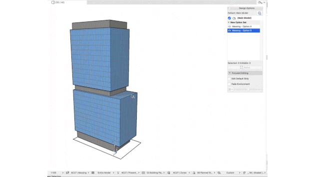

Use the Design Options palette to quickly turn Options on and off as you work. The open-eye icon quickly lets you know which design option is visible, and the blue check mark indicates that it is set as the Default so that any modifications will be applied to it.
If you need a clear differentiation between the general model and the new editions. you can focus on editing the current Option by locking, fading, or colorizing other elements outside the current Option.
In the image above, you can see that the Workspace - Option B is selected as the Default with the blue check mark, and since we have the Focused chosen options on, you can:
Edit Default Only, which only allows you to modify the elements present on Workspace - Option B
Fade Environment, where anything not belonging to the selected default option is faded. While the elements belonging to it appear with darker colors, you can adjust the transparency and choose different colors for the Fade Environment.

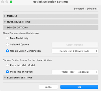

Design Options integrate seamlessly into the Hotlinks workflows. Work with embedded variations, place a module with selected options, or change it later, all at the instance level. On the Publisher menu, it is possible to save and publish Hotlink modules with all Options included or alternatively, with just the Options visible for that view.
By following the usual Hotlink process, you can find a new section dedicated to Design Options on "Place Hotlink window" as well as on "Hotlink Selection Setting", which lets you place elements from the Module as an individual Design Option or a Combination, and decide if the new elements should be added to the Main Model or into another Design Option of the Host file.
