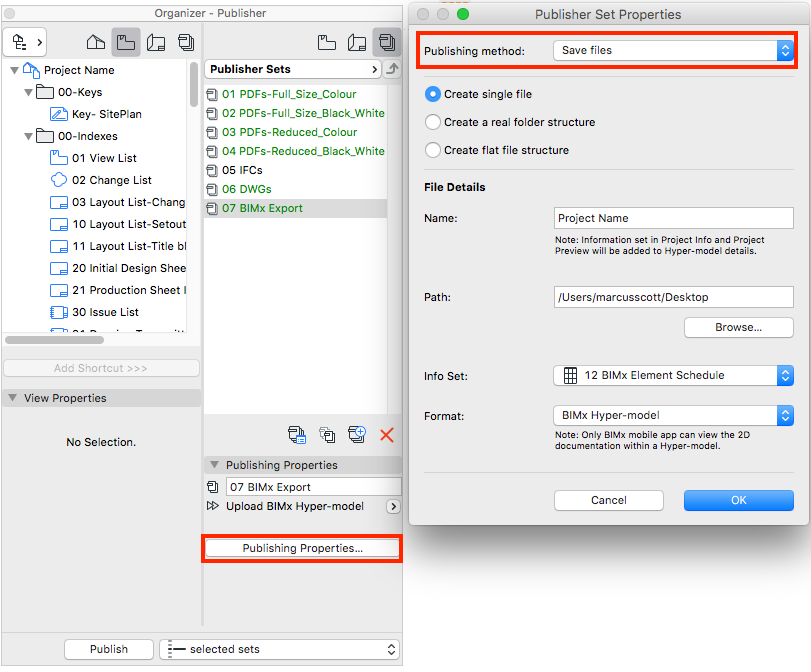

Since the save as option for BIMx was removed
How do I export my model without publishing it to the web, if I just want to save a BIMx desktop viewer file.
There should be away to save BIMx files anytime then upload them using an upload function under BIMx website.
The save as is the only way I can see to do this.
Can anyone explain why this feature was taken out of the save as menu?
Can we add an option under publish to save to drive, that doesn't look for graphisoft ID or any internet services?
Additionally there is no option to render GI once saved in BIMx the only way is to publish it and choose the option when publishing it.

Hi there,
You can publish BIMx models locally by setting Publisher Properties to 'Save Files' with the Create a single file option checked. I've attached a screenshot for reference.
Kind regards,
Marcus
Yes, I am aware of that option but you still don't get the same results as before.

Yes this could become a problem
previously with the save as .bimx file option it would take far less time
Also, when you open the file with the bimx viewer there is now no way to resave it with adjusted setting changes within bimx
We would previously turn the shadows on and adjust the view cone or head height to suit each model so that when the client opened the final file the job was as we intended to view it.
the client should not be expected to go in and change these settings, this is just ridiculous, why does graphisoft intend on changing things that worked perfectly fine beforehand.

Exactly what I was thinking! Now I have to go back one version to save a normal BIMX file.
