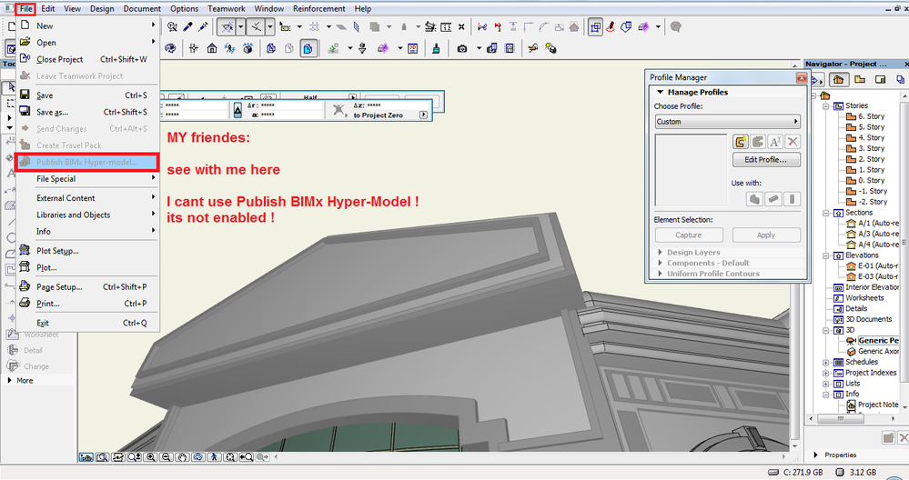

the easiest way:
File > Publish BIMx Hyper-Model
You could also see the other options here

THANKS Alot .....my friends
but. sorry ..
I want to say something
I've been working in ARCHICAD 17
When I want to save the project to the BIMX .. follow these steps:
1. open a 3D window
2- file>save as>select ".bimx" format
3- finally ! click on save button .....
NOW !
I followed your method ....
but I have new problem
you can see it in the image
thanks agin !

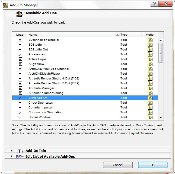

Check your Add-on manager (in the Options menu).
Sounds like your add-on is not installed.
As far as I know it is not a separate add-on that you can install yourself.
It is automatically installed when you install Archicad.
All I can suggest is to re-install Archicad.
But maybe wait a bit to see if anyone else here has other suggestions.

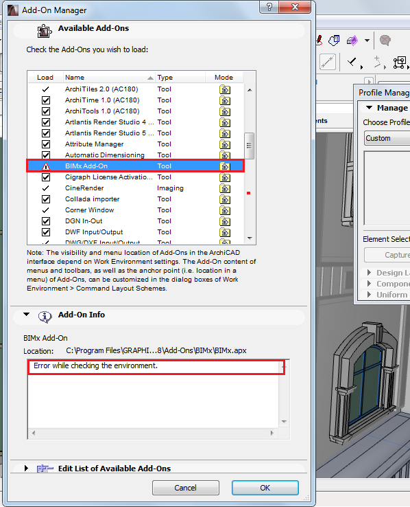

THANKS for your suggest...
my dear .. I check about my add-ons in "Add-on manager"
and I found this problem next BIMx add-on.. in the image
NOW !
Iam re-install BIMx add-on
or / re- install ARCHICAD.
THANKS ALL ..FOR YOUR HELP .. I STILL WAIT FOR HELP
I found another post where someone had the same problem.
It seems re-installing Archicad fixed it for them.
http://archicad-talk.graphisoft.com/viewtopic.php?t=49220
