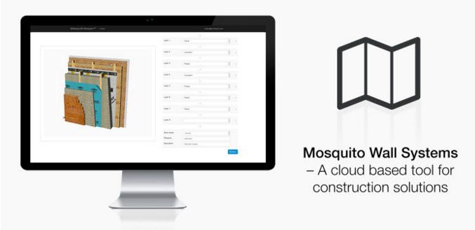

Anyone tested this or using it with 19 ?
http://www.mynewsdesk.com/uk/bimobject/pressreleases/bimobject-r-mosquito-wall-systems-new-cloud-bas...
Objects are created in the server environment in WEB GL and then automatically created a .gsm or that other BIM file format.

In the case of Mosquito and the wall creation cloud app, we are saving out an XML file too, which can be then imported into ArchiCAD via the Attribute Manager, the gsm file, which is also created, is purely for illustration purposes, it is like a high level of detail, 3D detail.
In the XML, you will find all of the necessary 2D fills, building materials and composites.
