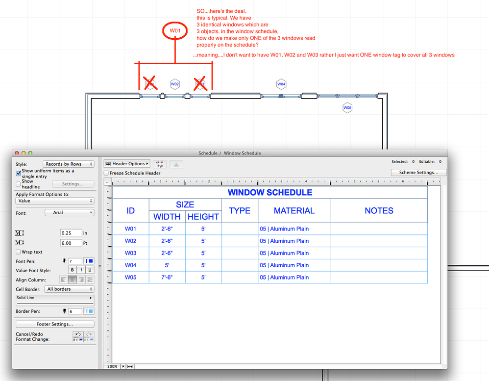

So..we have 3 identical windows, they are casement windows which open outward (all 3) in the same direction.
We need to show them on the window schedule as "ONE" window tag only....how do we accomplish this?

Ben Cohen
Hi Rob
If you remove the ID from the listed fields they should then group together. But of course you would like to show the ID and then have the field collated, showing W01,W02,W03
NOT POSSIBLE I'm afraid.
At the moment GS doesn't see this as an important requirement for scheduling. I think MOST users would disagree.

Eduardo Rolon
Rob, I think we have discussed this before but in my setup I use two schedules;
• one for a list of all of the windows by number
• one for the type of window which is graphic

rob2218
How can this "NOT" be important. You have 3 identical windows...side by side separated with say a 2" piece of framing....yet you want to indicate them as "ONE" window with the opening being the width of the 3 (plus the framing) to read as all together....
I know they are three windows but in the REAL world, sometimes, the builder/contractor/estimator...the entity building the darn thing.....knows he has to order 3 of the same windows to fit in ONE large opening and as architects we need to be able to graphically indicate in plan that the three windows are indeed acting as ONE window and we'd like it to be computed as such....

sinceV6
Why don't you build it using the triple sash window, or the multi sash window. It will then schedule as a single window; but then you will need to make a note somewhere for the builder that they are actually three windows of the same size.
Don't think you can have it both ways.
OR
you could have your 3 windows the way you made them, tag only the middle one, schedule them as 3 separate windows (quantity to buy), but if you make a separate schedule for the type (to show elevation), you could use a separate elevation to show that window only (and if you don't like having a separate full blown elevation just for that window, use interior elevation, or even make a frontal view 3d document)
OR
the simpler option: make them the same ID.
