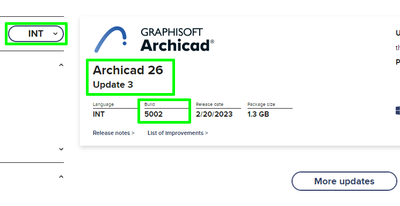

1 ACCEPTED SOLUTION
Solution
Hi @Frillex,
This issue is fixed in AC26 update 3. But not for all localisations yet.

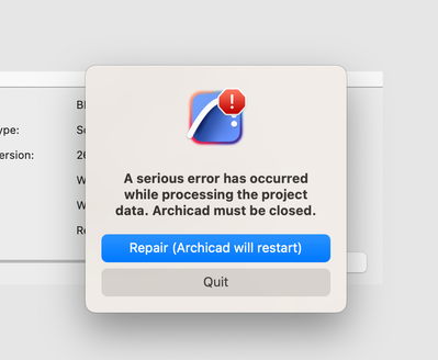

I've just tried it and get the exact same issue. I have contacted our local support to see if they can shed any light on it.

Just had this back from local support.
'This is actually a known bug in AC26, DEF-10919. The fix is already done and will be released with AC26 Update 4. Until then, please avoid using this option'.
So good news it has been fixed, just a wait for the update to come through. If you launch Archicad first and then use the File, Open command and select the option to 'open and repair' the file should open. If it doesn't, you should be able to send it to your local support team for them to forward to the developers at GS to repair for you.
