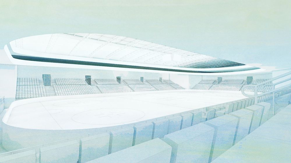

I found the theater/stadium seating library from archicad adequate as well. You need several separate objects placed to get a decent layout of seats, but it works.
Below something I mocked up a long time ago, using those parts.

The seating like this does not work as the drawings for construction have to be created and the cells are already there to use.  I am still evaluating where to land - and I want it to be here.
But the time to recreate what they have in a Revit cell is 30minutes  vs 30hours time so far.
ModelPort helps may be my solution.  The concern is when I get a model with 10,000 seats.
