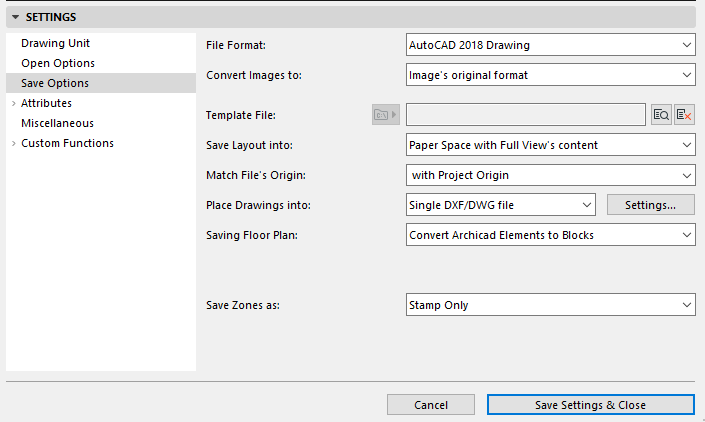

I'm unable to create a working single DWG file when publishing into DWG.
I mean, the dwg file is created, the views are in the model space, but the layouts are empty.
Anyone is facing the same problem?
Is there any limitation for "merge into one file" option?
Any trick to solve it?
Below the settings I'm using with no success.

I can see missing options on your translator save options, maybe the default Archicad DWG translators you use are corrupted ?

in the INT version those settings are not present ...
