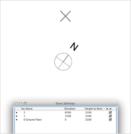

Most projects that encounter troubles later on, do so, because of the lack of preliminary coordination! Organize a BIMCoordination meeting to agree upon the following:
  • project location and coordinates
  • Project North direction
  • Story setup

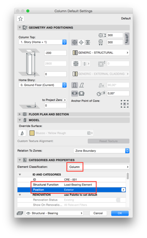

Set Element Parameters
  • Define the Structural Function of the element
  • Set the Position of the element within your project
  • Set the IFC Classification of your element
  • Enable the necessary IFC properties for the element or create mapping rules
