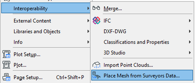

I tried to import using the 'place mesh from surveyors data' using the supplied .xyz file but Archicad says it cannot read the data and exits.
Maybe not formatted correctly? It wants x, y, z in three seperate tabbed columns.
