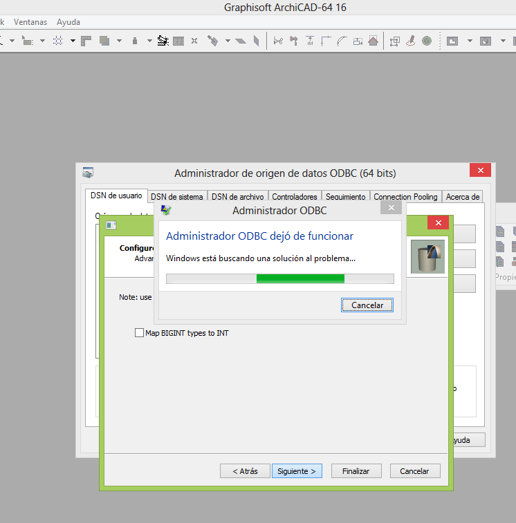

I'm using a computer with windows 8 and Archicad 16 64 bits. I'm trying to create a DNS with Archicad 64 bits ODBC. But, when i've specified the .pln file and select 'next' on the dialog box, it crashes and give me an message "ODBC Manager stop working" (something like that, i'm from Colombia and all my software is in spanish). I've attached an image.
Someone with this problem too? what is your solution?
