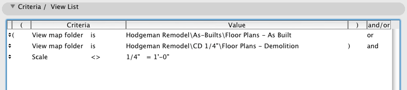

I use View lists and Drawing lists to audit (and correct) view and drawing settings. For that, I display everything usually.
But, these new settings also give criteria for those indexes. (Not yet all of the possible criteria keys for Sheets, cannot specify "Missing" for a Layer Combination, etc yet, but hey this is huge progress.)
Another sort of unlikely example attached. The criteria shown would list all views in either the As-Built or Demolition view map folders which were not 1/4", which all are supposed to be in those folders. So, if any views are displayed (and I would display all view params including the scale), then I know there is an error.
(Another caution: If I had used the AND operator for the folders As-Built and Demolition, then there would never be any views displayed - no view can be in two folders at the same time.)
