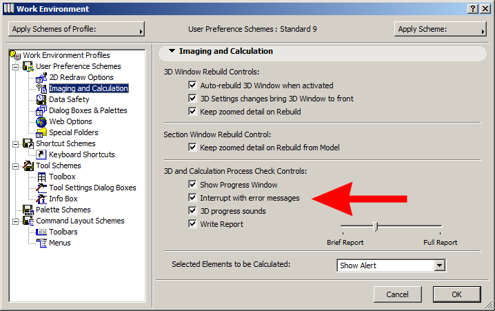

First of all I feel embarred to say that I don't know how to activate warning messages in archicad
Second. I've test a file with a single stair made with archistair in the laptop. Uninstalled archistair and opened the file. The green dot is present, but no stair. Reinstalled archistair. Opened the file. The stair is present but I can't make modifications. And of course, I can't make new stairs....

FIRST: look at the attached image, it shows you how you can enable/disable the warning messages.
SECOND. You see the stair but you are not able to modify it... what do you mean?

I have the warning message check box activated. (and I always had). I didn't realized.......
OK, I've opened in my laptop the file with the stair (that was created in my desktop). If I try to modify parameters the dialog box appears, I make changes, and when I apply the modifications nothing happens.... The same when I create a new stair. I pass through all the dialog box, select the type of stair, adjust parameters, press OK, and nothing.... the latest archicad tool remains active....
