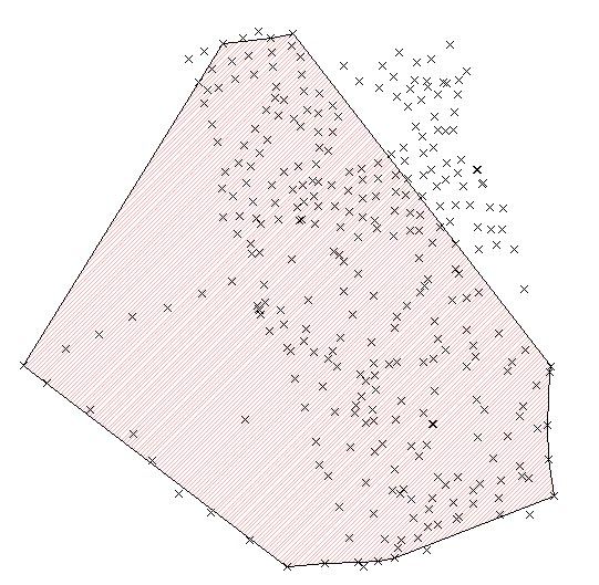

I wish to create a rectangular outline, so I can have a mesh, the extents of which (footprint) fill a rectangular area. The AT outline tool has a "rectangle" mode, which suggests this is possible, but whenever I use it, AT gives me an irregular shape of its choice!??! In creating the irregular shape, it ignores the data provided by many of my points.(see image).
What's going on in this case?

Once again the otuline fits to the existing points/hotspots.
It identifies the terrain perimeter so any vertex of the outline should overlap an existing point/hotspot.
Looking at your terrain you don't have four point/hotspot to do this!
you can manually insert these four points (pay attention to their levels) and then use the outline tool.
If you use the rectangular mode this doesn't mean you will get a rectangular shape: it simply means you have to do two clicks then ArchiTerra will try to automatically find the outline... but if the shape is quite different from the rectangular one it could skip some points (as it's doing for you).
In this case it should be better to use the polygonal mode that requires more clicks...
