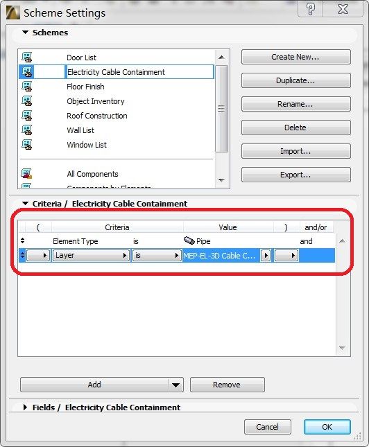

Kent wrote:
I want to have the schedule of showing the length of the duct/pipe. I attempt to set the criteria to be "Layer" & “pipe", and choose the fields to be "Layer" and Length". It is strange that the schedule only display the pipe with length of 1000mm.
Any idea for showing the length of the MEP pipe/duct?

David wrote:
Kent:
If you open the Settings for one of the pipes, you will see that there is no Length or Width parameters, and that the Length is listed under the Parameters section. To get the length of pipes (and other MEP parts) you will need to use the Add Object Parameters button under Scheme Settings, then search for the pipe object and add its Length parameter to your schedule.
David
