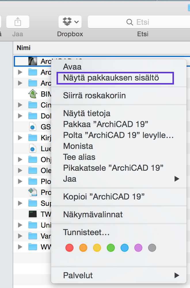

Hello,
No need to screen capture on Mac;
- right-click the ArchiCAD application...
- choose "Show package content"
- find all the icons in the folder "Content -> Resources"
Icons are found here.
This is ArchiCAD 19, but 20 has the same structure.
Hope this helps / works.
