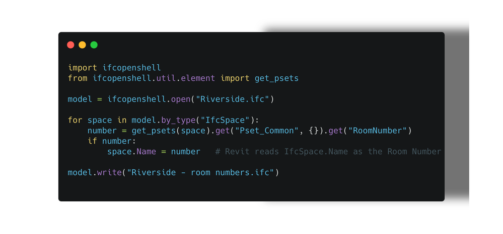

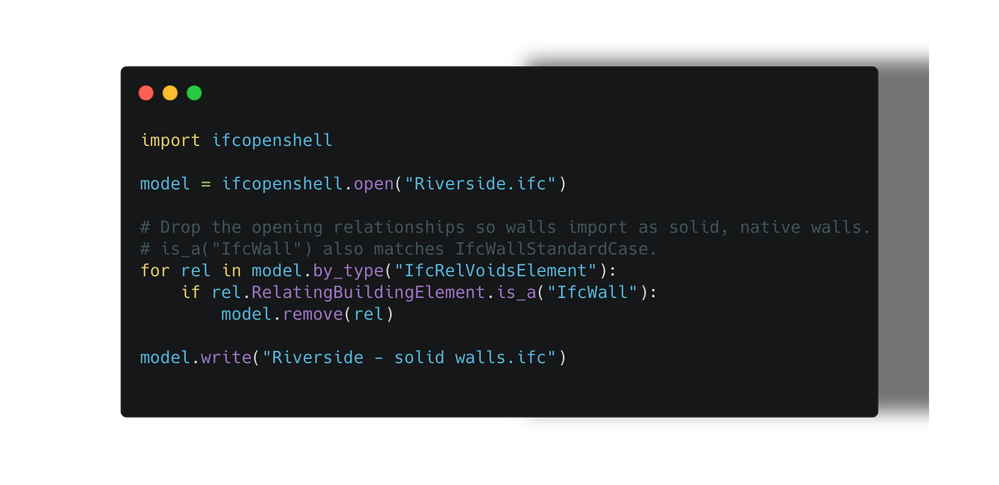

That left one more oddity: every classified wall that had an opening in it still came into Revit as a Generic Model, while the solid walls imported natively. I couldn't pin down exactly why, but my best guess was the void itself tripping up the interpretation, so I used IfcOpenShell to remove the IfcRelVoidsElement relationships on those walls — and empirically, that fixed it. The walls finally came in as proper native walls, with the doors and windows still sitting in place as reference. While I was in there, I also fixed the room numbers: our zone number was ending up in a property set the tags couldn't read, and since Revit uses IfcSpace.Name as the Room Number, I copy it there — just for the units and common areas.

unfortunately I can't share them since they belong to the firm I work for. But I'd be more than happy to help if you run into any questions. I took the liberty of saving a few code snippets I used to fix the classification on the IfcOpenShell side, since it was a pretty unconventional step.
