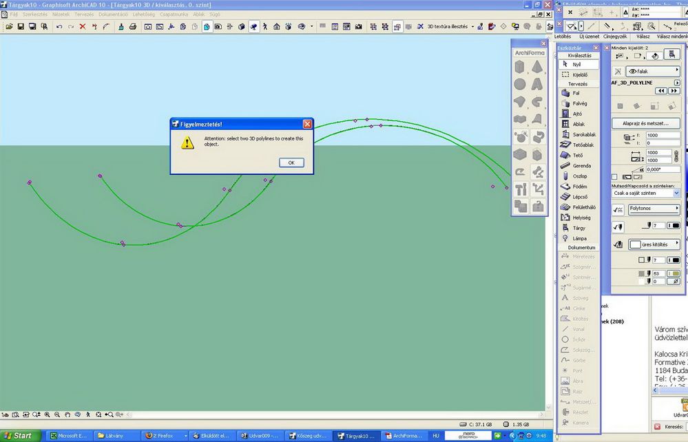

Does anyone know Archiforma? I've tried to make a surface from two 3D polyline with Archiforma but I couldn't. A window popped up with the following sentence: "select two 3D polylines to create this object." I don't understand it because I selected two 3D polylines as you can see in the picture attached. What can be the problem?

In order to be able to create a surface the two polylines must have the same number of nodes. At least this was the problem seveal years ago. Then I gave up ArchiForma for surfaces, because it was /and still is/ much easier to make the surface in Autocad or Max.
