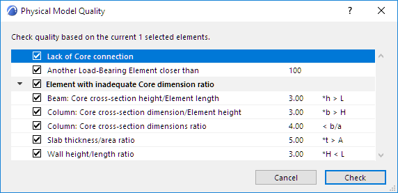

Use this tool to double-check the physical model adequacy for the continuous structural analytical model generation within Archicad. You can access this tool under Design > Model Check > Physical Model Quality.
This tool contains a checklist of parameters. These checks are focusing on the physical construction adequacy of the elements regardless of their structural function, except for one parameter, namely, Another Load-Bearing Element closer than. Each parameter is briefly described in the Reference Guide, see Physical Model Check Parameters section.
This tool is considering only the visible elements, which can be limited by selection or view settings. If you run the check with some elements selected, only the selected elements will be checked.

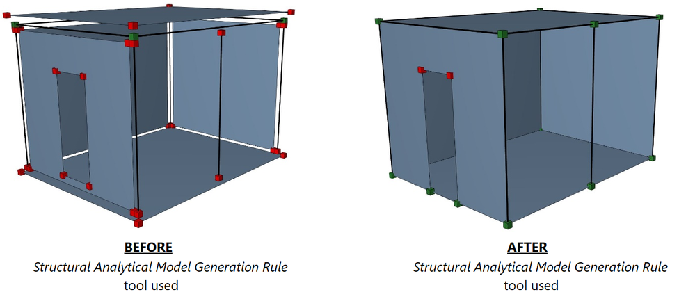

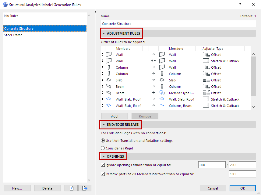

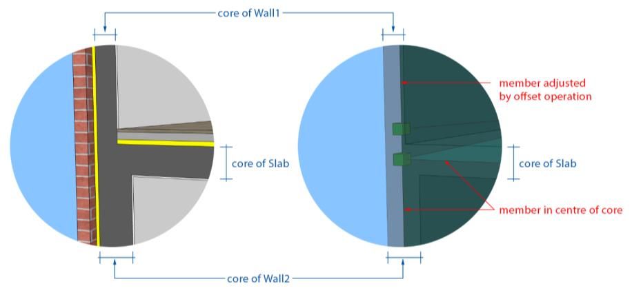

Once the requirements are fulfilled in Archicad, the structural analytical model is automatically generated from the physical model. By default, the structural analytical model is generated in the center of the mass of the elements’ core section. This default model can be easily modified with rule-driven adjustments to achieve the required continuous structural analytical model. These rules adjust the analytical model geometry of the load-bearing elements and certain end/edge release definitions. The purpose is to optimize the structural analytical model to make it correct and compatible with external finite element analysis software.
You can access the Structural Analytical Model Generation Rules tool from the Design menu or by simply choosing it from the Structural Engineering toolbar as per the below figure.
The current Generation Rules automatically go into effect whenever you turn on the Structural Analytical Model view.
Each set of Generation Rules includes:

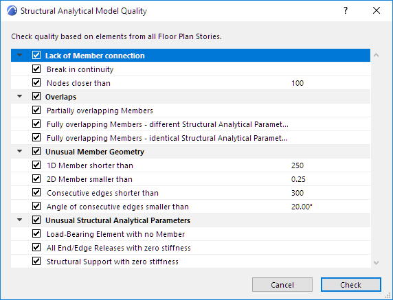

Use this tool to double-check the structural analytical model adequacy before the model exchange with external finite element analysis software.
You can access this tool under Design > Model Check > Structural Analytical Model Quality.
This tool contains a checklist of parameters. These checks are focusing and considering only the structural analytical model adequacy of the load-bearing elements and not the physical model of the elements, except for one parameter, namely Load-Bearing element with no Member. Each parameter is briefly described in the Reference Guide, see Structural Analytical Model Quality Check section.
