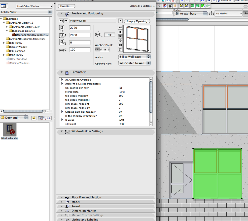

when creating a new window, and placing it in a wall, all is fine.
But when you come to edit the window and call up the window selection settings box again, we find that the editing options for frame, glazing, trims, in fact all of them are now gone, and we are presented with a blank windowBuilder Setting window.

that looks like a permission error on your 'Cadimage Libraries' folder. check that your user has full(read and write) access to it and all subfiles/folders.

No issue with permissions.
Cadimage have acknowledged that it is a bug, and should be sorted in the next hotfix
