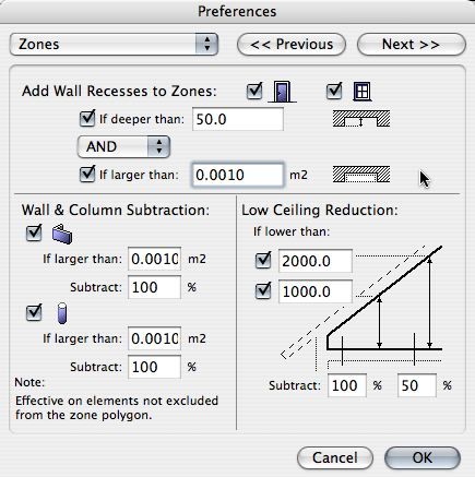

__archiben
try your zone preferences?
~/archiben
b e n _ f r o s t
I had tried that before, and tried again after your kind suggestion with new file this time: Update zone and preview again with several variation in decimal, then with different window types, and finally do exactly as your screen shot, but disappointingly, they all failed
I have also turned on extra accuracy at Calc Unit preference. Nothing seems to work...
Oh my, is that bug?
