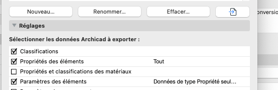

With the same ifc export translator I have got the classification of each element into my IFC 2x3 export from AC25 but I am not able to get classification of each element into my IFC 2x3 export from AC26.
The classification parameter is OK and I use the right ifc translator 😉

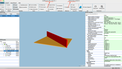

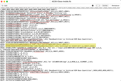

I have found why sometimes we are not able to read Classification into an IFC 2X3 which came from AC26.
The information about classification is right exported from AC26...
But Evebim (and Navisworks too) are not able to read it from AC26...
While Evebim (and Navisworks too) are able to read it from AC25...
BIMcollab ZOOM is able to read class information about the same IFC 2X3 exported from AC25 and AC26....
All my tests are made with the same Archicad project, the same ifc export parameters so with the same IFC 2X3 files too ; the only difference is which Archicad export the IFC model.
CONCLUSION
1° - Archicad 26 handles the export of IFCs differently from AC25 using the same work file and the same IFC export parameters.
2° - BimCollabZoom is able to read the information exported by AC26 within the IFC file where other solutions cannot; EveBIM and Navisworks for example.
