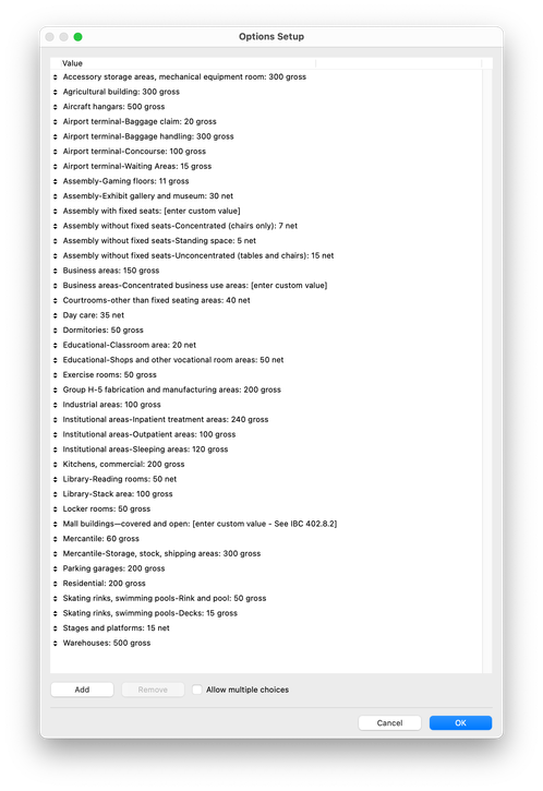

Stuart Smith
The Space Function property is an Option Set with all the space functions as listed in the IBC
The Occupant Load property derives the numeric value from the selected Space Function property using STRTONUM (string to number):
All the user has to to do is select the appropriate space function from the list and the Occ load gets calculated automatically for that zone.
