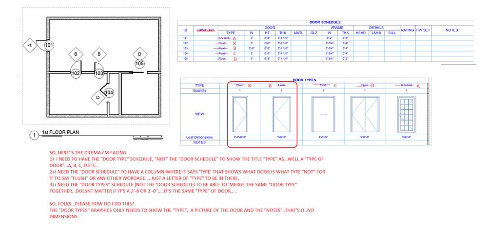

I tell ya GS...these "schedules" whether they be "door types" or "door schedules" are the worst.
it's like I have NO clue how to get a simple "DOOR TYPES" with the door type letter (A, B, C, etc..) and by grouping the same "TYPE" of door whether it be a 2'-8" or 3'-0".....it's still a "B type" door......
and also, how to get that "door type" information to be coordinate inside the "DOOR SCHEDULE".....
I can't believe this is this hard to create and why something like this isn't a simple STOCK list in AC18.
Yes, there's a door types "list" but it doesn't work as it should.
In the U.S., "door types" means just that...."what type of door with a letter is represented in a door schedule and shown as a 2D in the "door types" chart.
....please..I need some help.

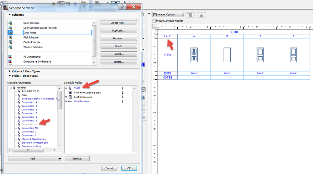

It looks to me like the simplest way to get the schedule to show a door TYPE in terms of A, B, C… and still maintain all of the parametric functionality you need for managing the door schedules, is to just add a Custom Text like this: (See picture)
You can't make the door ID display as letters in one place and numbers in another. Since you are using the door ID in your floor plans as a Marker you can not use the ID to display as a letter in the schedule.
Or if the only thing that defines a Door Type for you is the panel/leaf of the door, you could just rename the panel/leaf to A, B, C, D…and schedule that.
In the case of Window Schedules, I would reverse the numbers and letters.
Use numbers for Door ID's and letters for Window ID's.
You can very quickly change all of the window or door ID's to letters or numbers using the Element ID Manager which is a very powerful and easy tool to use.
It is also very important to keep everything in the schedules parametric with the ID's in the floor plan for the sake of managing the ID's efficiently.

And your Door Type schedule would look line this:
Steve Jepson
I like to to turn on the door label to show the Door ID and I use the door Marker to show the Door Size.
If you only want to see one or the other just turn it off.

1) I do NOT need to show letters in one place and numbers in another.
2) The "Door Schedule" has door numbers, that's fine.
3) The "Door Schedule" needs to contain a column that indicates a "letter" which relates to a "Door Type" (A, B,C ,D..)
4) The "Door Type" chart (cause that's really what it is, a pictoral front elevation of the door panel) should only have in it a column (or row either direction) for the "door letter" (that's the type), door picture of the front, that's the 2d graphics of the door panel, quantity count, and "notes". The "Door Types" chart does NOT need to have the door dimensions. That's being indicated in the "Door Schedule".
5) On the floor plan, I only need to "see" (not hidden) the door number, i.e. 101, 102, 103...etc. I don't need to see the door types in plan BUT ALL the doors need to be cross-coordinated with the "Door Schedule" AND the "Door Types" Chart.
This is traditional documentation 101 folks....really. I have not a clue why Archicad names "Door Types" and I can not alter the "parameter" in the "door types" column to a letter "A, B, C, D" etc....
So...what's the process for making this so?
I can't rename the panel leaf, that's just it....when I click on the pull-down from that column (where it says "Door Type") alls I get are the "forced" types, such as "flush, sliding, etc..." there's no way to put in a "letter" in there, at all.
Also, it appears I need to have the "leaf size" as a criteria because if not...then only ONE door will be seen in this "Door Type" chart. Now...why can't I have the same "door type" such as all FLUSH for example, simply show up on this chart and grouped together....dunno, it's very very difficult these schedules.....since day one, they have been.
