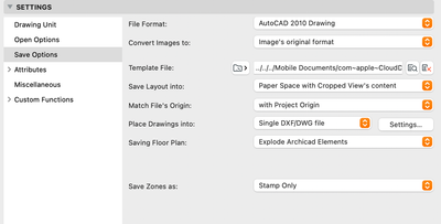

I am trying to export the exact publisher layout in dwg format for consultants.
I am only able to export drawings or with xrefs.
I need to export one single drawing as a dwg that has the title block and all.
I am new to Archicad but experienced Revit
I am using 24
Thanks in advance

Eduardo Rolon
The X-Ref is a setting in the translator under save options.
If you want to export all the Layout info you need to use Publisher and the DWG will have the info based on the setting for "Save Layout Info"
