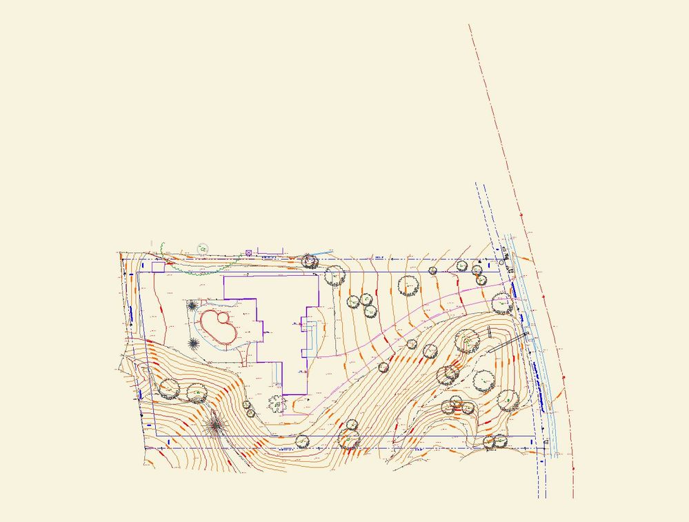

I just discovered that when I merge or open a dwg in 8.1R1 I get a topo with all the contours. This is as I am used to. When I instead xref the dwg file, I instead get just the major contours (every 10') and when I tried showing all layers I got what looked like a mesh in plan and still no intermediate contours.
Why does the latter happen? Why do I not get intermediate (every 2') contours like when I merged or opened a dwg in AC? And what was it that I saw if it wasn't a mesh?

Attached are 4 jpegs from the same dwg.
Xref 1 : I attached the dwg as an xref, R2000 translator
Xref allLayers: I just tunred on all the layers
Merged 1: what I got when I merged the dwg
Merged all Layers: when I turned on all the layers in the merged file.

I think that when you import a dwg all the lines and thier layers will be processed by AC wether they are on/off lock/unlocked, frozen/unfrozen. If you Xref then the AutoCAD file retains control of what it is shown and if the layer is off then in AC the layer will be ignored.

I had forgotten that one can always open dwgs as a library part. Thus I was able to see(see attached) that there is a 3D mesh in there as well as 2D info.
I've attached shots of it in the plan window as well as overall and zoomed-in axonometric shots.
Now that I understood what I was being sent I could choose which opening/attaching method would best serve my purposes.
